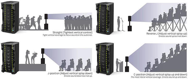

Which "pattern" is best for the F1 812 for an audience that is seated and the band is playing on the floor and NOT on a riser/stage? Thanks!

You can mount the F1 Model 812 on top of the F1 Subwoofer with its integrated stand or you can put it on a tripod stand. In either case, if the audience (ears) are below the bottom of the F1 Model 812 then use the J-position. The J-position is the bottom left picture.
