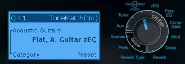

1. Is there a good tonematch preset recommended for the cello? I've tried a few Bass Presets which boost the LF more than I like. I currently have it on a flat utility setting, I probably have some LF cuts, but that changes frequently depending on need.
The Cello goes down to about 65 Hz or C2. That's only 15 Hz (two notes lower than a guitar). Take a tour through the Acoustic Guitar presets.

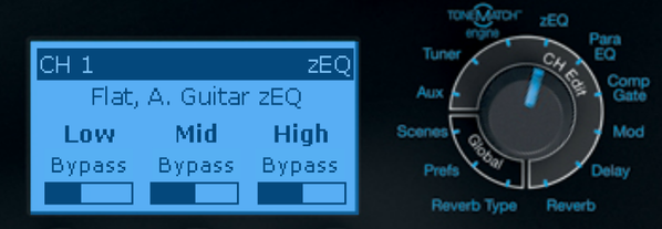

2. Is there a way to get a high pass filter from any of the EQs? I get a fair bit of LF noise from fingers and the general resonance of the instrument that is really distracting. If I'm too close to the L1, it gets worse. It's not really feedback, but it might be.
I think this is some low-frequency attenuation or a high-pass filter in the acoustic guitar presets. The details of the Presets are not published, but that is what I hear. Try this:
Try this:
and then use the zEQ to fine tune.
Take a tour through all the Acoustic Guitar presets to see if there's something you like. Check out the Taylor Guitar Presets too. Try the ones that include the word "strum" in the description.
3. I believe the channel gain is set correctly (green lights, rare blinks of red),
This sounds right.
but at certain point, no matter how far we turn the channel volume up, it doesn't change the perceived volume.
When you hit the point turning up the channel volume doesn't change the perceived volume, you're at the limit of what the system can output. I think the issue may be alleviated by using zEQ to reduce the low end.
This is a starting point. Experiment by further reducing the Low setting until you hear an improvement. If you want to really hear what is happening, you can press the left-most button under the display to Bypass the zEQ setting.
Press that same button again to return to your current setting.
