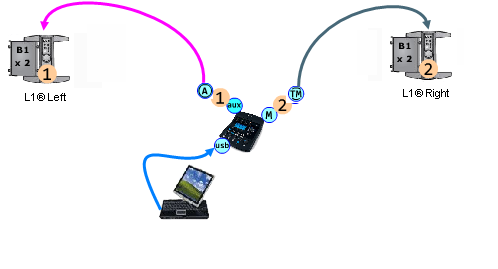

Hi, I am demoing a second L1 MK11 today!!<BR />My question is how do I best connect both systems?<BR />Ive heard that its best to connect them so that the vocals go through only one Tower?. and backing through both in stereo. If so how do I connect for that?, where do I plug everything in?.I have 2 B1s also. Do I place the B1`s in the middle or one with each L1?Also how do I balance both L1 volumes?

Click the picture below for full details on how to run two L1® Model IIs in stereo using your USB connection to the T1® to two Model II Power Stands.
–?8T? Please click the picture for more details ?T8?–
This looks a little tricky at first, but once you’ve got it going (and save the settings as a T1® Scene) you shouldn’t need to make any adjustments except to control the volume with your computer.
After you have this going, just connect your microphone to T1® Channel 1 and the sound should come out of only one of the L1®s. In the picture above - that would be .

If you are running the L1®s in stereo (and the backing tracks were originally recorded in stereo) you are probably fine running two B1s attached and close to each of the L1®s.
IF things sound odd, hollow, or lacking in bass then you want to try putting the B1s together.
  • Connect the B1s as normal - two per L1, and put the B1s together in the middle. This means that you will eventually want to get one or two longer B1 cables. With the standard Bose cables (blue ones) you will only be able to get the L1®s about 10 feet apart. That will work to give you a trial, but you will want to get more distance between them to see more benefit from having two L1®s.
