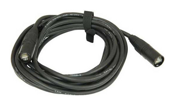

Any idea what the Tone Match cable looks like. By the way, how come the power unit is no longer needed?
Hi Wayne,
It looks like this.
Close up of the connectors.

If you still have the T1® box, lift up the cardboard insert. The cable is probably in the bottom of the box.
  • This cable carries both the audio from the T1® to the Model II Power Stand  and
  • the power from the Model II Power Stand to run the T1®.
In a pinch, you can use computer network CAT-5 or CAT-6 cable.
