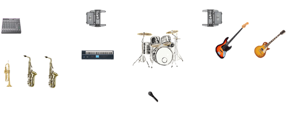

Do you have a picture of the band performing with the L1s?  I'd like to understand where you have the L1®s positioned.
I will see if we have a shot from our video session. Thank you for your quick reply. I love the sound of my speakers and the portability. I carry everything myself and set it up myself. Not bad for a 68 year old.
Pat
Hi patmcnabb68,
Thanks for using the Sketcher.
I use two L1 Model II units and two B2 subwoofers.
I know it seems counterintuitive, but I would pan the lead vocalist's microphone hard to one side. You'll get more gain before feedback, and because the L1 Model II has such wide horizontal dispersion, the audience will still hear the lead vocal. I would pan to the system on the right in the sketch.
Carrying that idea further, I would also pan all the inputs hard to one side or the other. Check out this article: Cocktail Party Effect
Too high Mic/Vocal compression can also cause feedback.
Too high Mic/Vocal compression can also cause feedback. Too much Gain also.
