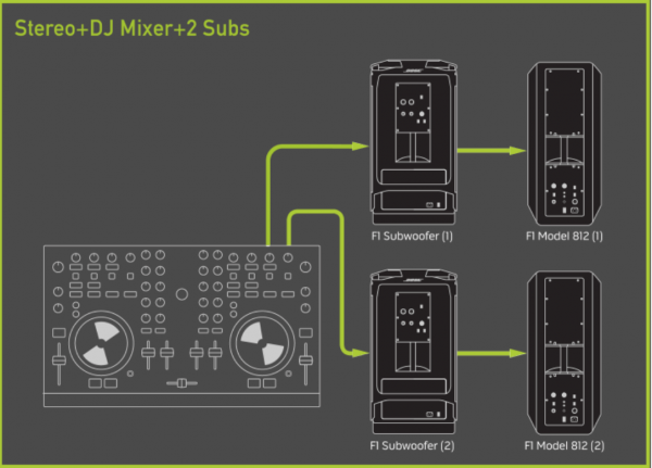

I noticed all the same , in my first test run. The biggest concern is heat build up. I would like for a rep to explain the difference , signal run to the f1 812 s first, then thru down to the subs. Thanks
I think this depends on what you’re doing. If you have a mixer or recorded music, then you can run to the subwoofer first, and then out to the F1 Model 812(s). All the use cases in the Owners Guide show this routing (F1 Subwoofer first then line-out to F1 Model 812(s)).
–?8T? Please click the picture for more details - Use Case Scenarios ?T8?–
If you have to combine an microphone and an instrument then you can use the two channel mixer in the F1 Model 812 and send the combined output to the F1 Subwoofer.
The other application where you would connect to the F1 Model 812 first is if the source was a relatively low level signal and you wanted to raise the level before routing to the F1 Subwoofer.

I followed the Manuel and did audio signal path (recorded music/dj setting) from the Denon mixer XLR cables output to F1 sub to F1 812.
But I didn’t understand , a user could run XLR to the F1 812 to F1 sub.
Just looking to use the Bose at maximum efficiency.
The output on the sub is full range correct? I would rather plug my inputs to the sub and then run the output of sub to the 812’s just to have one less cord running down from the top

Yes, the output of the F1 Subwoofer is full range.
Most of the use case scenarios in the F1 documentation show running the source to the F1 Subwoofer, and then running the output to the F1 Model 812.
F1 Use Case Scenarios
