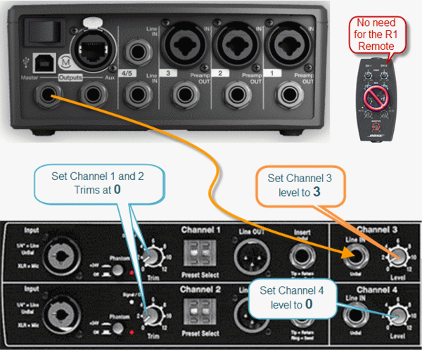

It looks as though it needs to be set at 3.
Hi, Perrin Madsen.
Yes, when connecting the T1 to an L1 Classic the input trim should be at 3.
For those reading along, we have an article about this: T1 to L1 Classic/Model I
