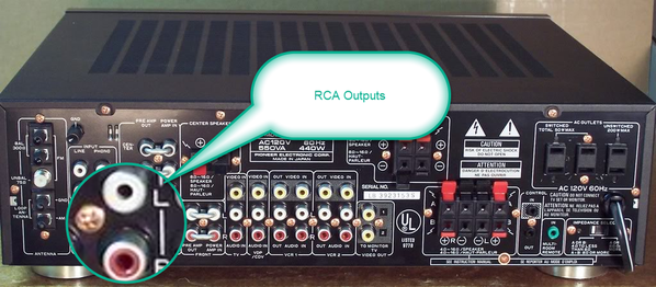

I have connected my two L1® Model IIs to a home stereo. This should work with any home stereo that has analog outputs. These will probably look like this.
Typically, these outputs are not controlled by the volume control on the home stereo. You will have to control the volume with the L1®s.
If you get a home stereo with a headphone output, you may be able to use that. Not all home stereos have one though.
