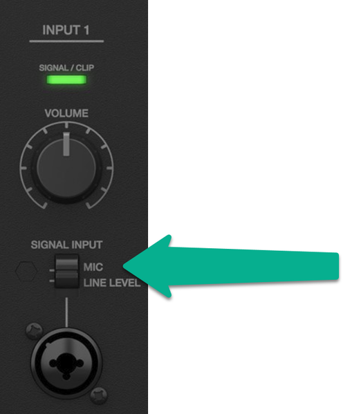

When setting the Volume Control on the F1 Model 812 you can turn up the Volume Control until you see solid red, and then turn it down a little. Occasional red flickers (up to a second long) are okay. This may start to happen at -5 dB before clipping or with transient peaks. You will see these to warn you when you are approaching clipping. If you see solid red then you may be clipping.
F1 Model 812 IO panel clip limiter lights
It is completely fine to turn up the Volume well beyond 12:00 o'clock if you need to.

I had this issue and as you thought the same as in not really loud but these speaker really do need a input signal at least 24db in my opinion. If you trim to at least that on the channels you will find it much better and also your mixer will not go to red into clipping.Someone mentioned in a post somewhere to switch the input signal to to MIC which I don't think is really recommended but you will notice the true power of these fantastic speakers without maxing out.
Hi Lee, AJ,
It's completely fine to set the Input switch to the MIC setting.
There is no microphone specific processing (EQ) applied here.
There's no harm as long as the SIGNAL / CLIP lights are not solid red.
