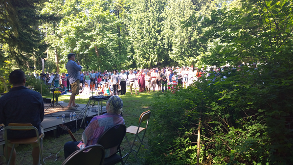

Please tell us about your show. If I remember correctly, you do a solo, acoustic oriented show: You and a guitar.
For a picnic, you might be fine with just the L1® with your B2.  I've done events for 800 in a quiet park.
We had a couple of L1®s on the stage, but we never used two for any one sound source. So setup was probably similar to yours.

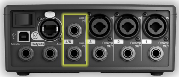

Regarding your reply that "ch 4/5 are designed to take a stereo input from ipad". I have a 1/8" to 1/4" TR jack.Can I plug that into Ch 4 and just run my 1/8" cable into that and the other end into the ipad? If so,what do I set Ch 4 up for on the T1?
Your reply raised another question for me. Will there be a difference in the volume output between the ipad into the Bose base and my vocal/guitar sound through the T1?
Or should i expect the same volume output?
Thanks for the pics of your gig.I envision a similar scene but with picnic tables spread out.I'm hoping there will be some sort of stage platform.I'll find out the details tomorrow.I'm actually meeting the organizer at the site tomorrow. I'm also hoping for a tent or overhang because I use an ipad for song reference and the glare is a killer. Thank you for your input.

The T1® Channels 4/5 are designed to take a stereo output from a device like your iPhone or iPad. That's simplest. You can connect directly to the Model II Power Stand Analog input, but you have to set your iPad or iPhone to mono. Then you can use a 1/8" stereo to two 1/4" mono cable. Use only one of the 1/4" connections to the L1®.
Hi ST,
The paragraph above, extracted from your post, is not clear to me. Maybe it's just me, but the part about setting the player to mono, then connecting to two 1/4 mono cable only to use one of them, is not clear. If you have time could you include a picture of the suggested cable and a clarification if warranted?

Also,I checked out the Farm venue I'll be gigging at.It looks similar to the pic you sent of your outdoor gig.Except there will also be a smaller crowd at tables behind me. So,I think I may need to use the additional external speakers to point towards them. What do you think?

Hi Oldghm, Steve,
Sorry guys, I was not using my regular computer. I couldn't do images.
This is how I would connect an iPad or iPod to the T1®.
Here's a quick video to help you to set the input trim for the T1® for backing tracks or pre-recorded music.

Thank you ST. What should I set channel 4 and 5 for?

Also,I checked out the Farm venue I'll be gigging at.It looks similar to the pic you sent of your outdoor gig. Except there will also be a smaller crowd at tables behind me. So,I think I may need to use the additional external speakers to point towards them. What do you think?
It depends on the size of the area behind you. Have you heard your L1® from behind? You still get some sound at the back. It isn't as clear, but it might be okay for people who want to get away from the music.
If you've got some powered loudspeakers then bring them with you in case you need them.

Not to beat a dead horse but I believe on one of these posts I read that Ch 4/5 are balanced.Would it make sense to use 1/8" trs to dual 1/4" trs. It appears the pic of the cable above is 1/8" trs to dual 1/4" tr..
thx
thx
Yes, T1® Channels 4/5 are mono balanced. However, the output of your iPod / iPad is not balanced. There's no benefit to using a cable like this:
and it won't work because presenting a stereo signal to a balanced mono input causes issues. Sound that is present in both channels is cancelled out.
