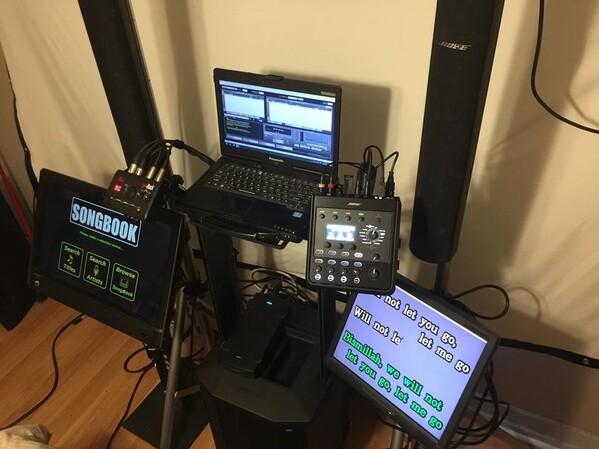

This is my Bose mobile system I currently use for karaoke and DJ services.
My system includes:
  • 2 x Bose MA12 Line Array 300 Watt speakers.
  • Bose F1 Subwoofer
  • Bose T4S ToneMatch Mixer
  • 1 x Packlite A1 Power amp (Used to power the MA12's)
  • DBX GoRack (Used for EQ and Auto Mic feedback control)
43879554_333174943913130_7771548313416892416_n
My question is about modding the F1 sub to power both the MA12's and Subwoofers.
Can this be done? or maybe in future will bose add a couple of Speakon outputs to the F1 subwoofer to also provide power to (unpowered) main speakers?
I'm just looking to "Lighten the load"
