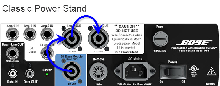

I run over to his L1® and put my ear to the Cylindrical Radiator®s. Nothing! Okay, so now I’m thinking, it’s a good thing that I still have a Compact in the car.
After a bunch of troubleshooting, (power off, power on, light is green, try a different channel on the Power Stand, re-inserting the Cylindrical Radiator®s in the Power Stand) I decided to check the amps. This something you can only do on a Classic this way.
I removed the Cylindrical Radiator® and then I moved the B1 cable to Amp1 out and I could still hear my buddy “testing testing” coming from the B1. Then I moved the B1 cable to Amp2 out and I could still hear him, “1,2,3” , again, from the B1.
Okay - so now I KNOW that the amps are working so I looked into Power Stand boot where the Cylindrical Radiator® goes.
Nothing unusual there, so I looked at the Cylindrical Radiator® bottom section that goes into the boot. Sure enough, the silver bar that attaches to the Cylindrical Radiator® is bent.
edit: Here is a picture I took of that bent bar a couple of days later.
It appears to have been bumped severely in transit. I’ve never seen this happen before, but it’s clear that the bent bar is preventing the Cylindrical Radiator® from seating properly so the connectors aren’t connecting.
It’s a minute before show time and I’m using a borrowed screwdriver to remove the silver bar. I then put things back together and we’re in business and ready to go.
I’m sorry - I didn’t have time to take a picture of the damaged bar. Edit: but I have added pictures of who it’s supposed to look. Edit: added a picture of the actual bent bar. Last photo in this post.
