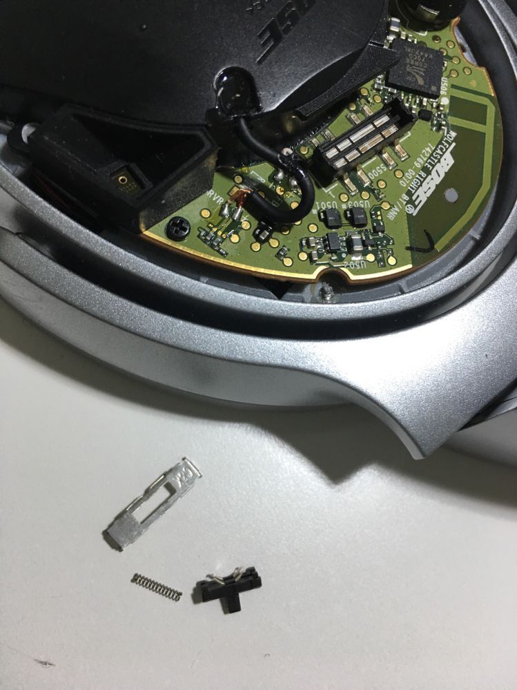

 Yes, I also searched for that slide switch a good amount of time, but no luck anywhere else. I saw someone online get it from that site I posted and I felt that was safe enough lol. I also got the switches delivered relatively quickly. I'm sure the one you referenced would work as well, as long as everything is identical.
As far as how to do it, I actually referred to a message previously posted back on page 39 of this thread where  provided excellent instructions and photos:
https://community.bose.com/t5/Around-On-Ear-Headphones/REPLACEMENT-ON-OFF-SWITCH-FOR-QC35/m-p/173964#M66941
Remember, just be careful and patient. In the copied picture below from that post on page 39, you'll see on the bottom left corner what you'll be replacing altogether. Same way you take it out is the same way you place it back in.
I had the same problem, tried method mentioned above and problem solved.
One thing to note, you don't have to peel off the felt to unscrew the 3 screws, just fold them up a little.

I just tried this fix after seeing so many positive results and the excellent instructions in this thread.  The first few tests are very good - so far no random, power-off connections!  I would caution all who try this when you reach the steps involving the switch internals.  Watch the switch return spring which is a loose part and can drop and be lost.  BE EXTREMELY GENTLE BENDING THE CONTACT PRONGS.  They are VERY TINY and are held in place only by the tension which you are bending against and can also pop out.  One of mine did and after much initial panic (to find it) I used tweezers and a small scribe to put it back in place.  After using tweezers to carefully place the switch internals back inside, the metal plate went back on nicely.  Power up was a big relief and I was happy to see the random power-ups seem to have vanished.  I will report back after some regular use.

This is a 'known' hardware issue (for over two years).  Bose stated here in 2019 that it is not fixable by firmware.  This is the only time I am aware of they have commented on it here.  The contacts in the on/off switch are likely slipping.  There is NO workaround.  If this is indeed your problem you have two solutions:
1. Fix it yourself with DIY instructions here and elsewhere
2. Ask Bose for an exchange.  For those out of warranty, they will initially offer the exchange for a price.  Take it or not - your call.  Those who have repeatedly called back and possibly escalated it report here eventually they will get to a representative that will be willing to do a free exchange, 'this one time'.

There is no replacement part.  You can fix it 'as is' with DIY instructions here or elsewhere.  See message #1092.
