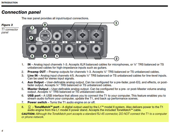

Out of interest, are you able to run from T1 into an ethernet switch and then out to multiple L1s using Cat5E cables?
Hi DJ Richard,
DJ Richard, Award Entertainment posted:
Out of interest, are you able to run from 81 into a ethernet switch and then out to multiple L1s using cable cables?
I'm assuming you meant to type 81 T1® and cable network cables.
We can't use an ethernet switch because we're not using ethernet protocol between the T1® and the Model II Power Stand. Here's a clipping from the T1 ToneMatch® Audio Engine Owners Guide
Thanks for that ST. That is pretty much what I thought, but it seemed like a reasonable question to pose in case my gut instinct was wrong. As for my typos, I'm not sure what happened there, but I do know that I was posting from my android phone, so anything is possible.
