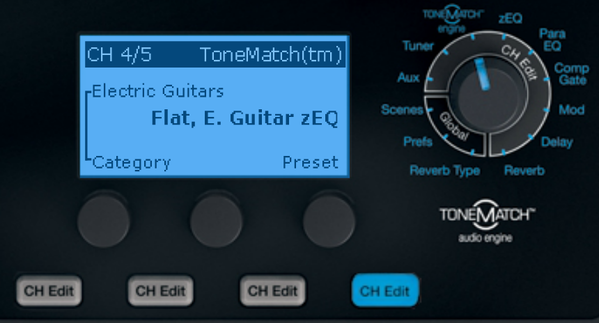

If you run the Kemper to Channel 4, you can use Channel 5 for something else. What did you have in mind for Channel 5?
Please note: Channel 4/5 is one channel with two inputs to make it convenient if you have a stereo source. As you apply changes to Trim, Volume, Presets, Effects, Reverb this will apply to both inputs on Channel 4/5.
If you can't get the USB from PC working, then you'll probably want to connect analog output from the MacBook to T1® Channel 4/5 so you get both sides of the stereo output.
You may not be getting that now connecting it to T1®  Channel 2.
If you get the USB from PC working, you can route it to Channel 4/5 (as in the video).
