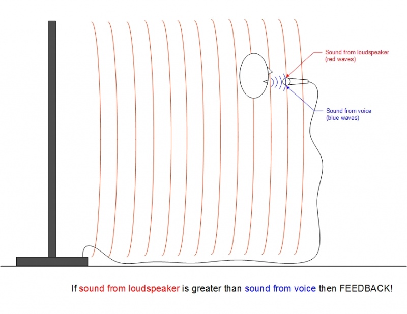

Hi Marco,
From your description, you are experiencing acoustic feedback.
Feedback occurs when the sound from the L1® Compact is louder at the microphone than the sound of the voice.
This is shown in the diagram below. Note that in the diagram an L1 system is shown but the same fundamental fact is true for ANY loudspeaker.
Microphone Feedback
If you understand this diagram, it is relatively easy to understand how changes in an amplification system and the room can contribute to either increasing or decreasing the likelihood of feedback.
I looked up your microphone, the Samson AH1 and it appears to be well suited to your task. You need to wear it so that the microphone is a close as possible to your mouth.
You may need to move the L1® Compact so that it is farther away from the microphone.
Do you have a photo of the room showing where you place the L1® Compact and where you normally Zumba in relation to it?

ST posted:
Hi Marco,
Microphone Feedback
Thanks for this explanation and the drawings
I have changed the position of the amplification system and it seems to work (no feedback occurred)
thanks at lot
marco
