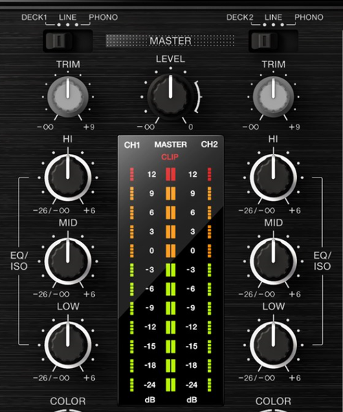

Hi fjcruiser,
It looks like your Pioneer XDJ-RX2 DJ Mixer has some EQ (Hi MID LOW)
You may not need to double-up and run the output of the mixer through the channels 1, 2, 3, or 4.
The best way to know which way works best for you is to try it both ways.
The big experiment is to connect the mixer to two of the 1, 2, 3, or 4. Then try the ToneMatch Presets for DJ (e.g., DJ / High Volume Music).  Give it a listen. What do you prefer?
