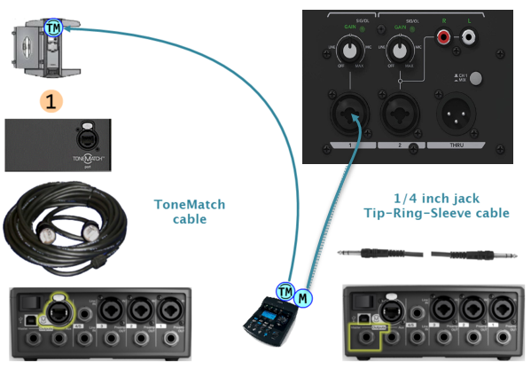

Hi Zoe,
I'm not at my regular location and only have a minute. Sorry. Please check out this article:
T1® to Two L1 Model II Systems
Read that article as though your powered speakers are replacing the L1® on the right side of this picture.
Please let me know if that makes sense. If not, please reply with a link to the owners manual for your powered speakers and I'll get back to you with an answer that is more specific to your situation.

Hey Zoe,
Like this....
