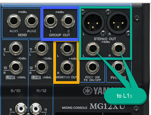

Just to remind you I am a mobile DJ and my setup is 2 sets of L1 M2 with 2 B2 i don't have a T1 so  the output come from my controller DDJ-SZ Pioneer  goes to my Yamaha MG12XU mixer and than goes to my speakers also I got a 2 JBL PRX 12 I use those to ceremony...I want to link JBL  with my L1
I am thinking this way let me know if you agree
Yamaha mixer to JBL to L1
Let me Know

I'm looking at the Owners Manual for the Yamaha MB12XU (you can download it from the Yamaha site).  On page 24 you will see that you have several outputs.
I would use the 1/4" STEREO OUTs for the L1® Model IIs.
You should be able to connect from the MG12XU to the JBL PRX 12 using the
  • Group Out (blue),
  • Monitor Out (orange) or
  • Stereo Outs [XLR] (green)
Please see the Yamaha Owners manual for more information about those outputs.
