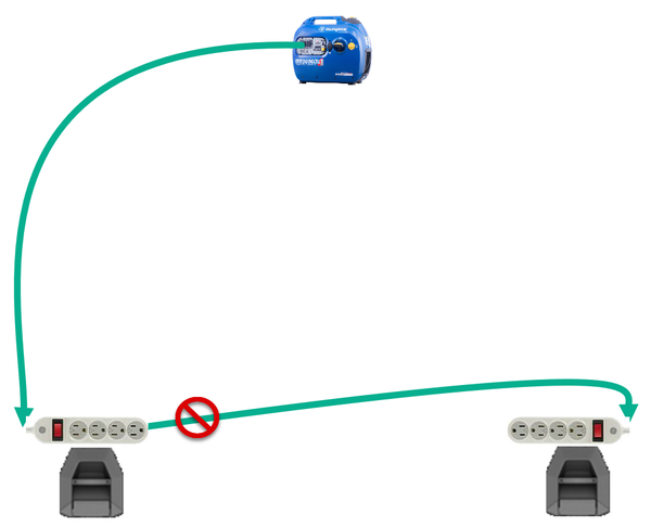

I would run two separate 12 AWG extension cords; one to each F1 Stack (F1 Model 812 with F1 Subwoofer).
I would not do this:
because the second F1 Stack could be at the end of 75-100 feet of extension cords.
What else will be running off the Westinghouse unit?
