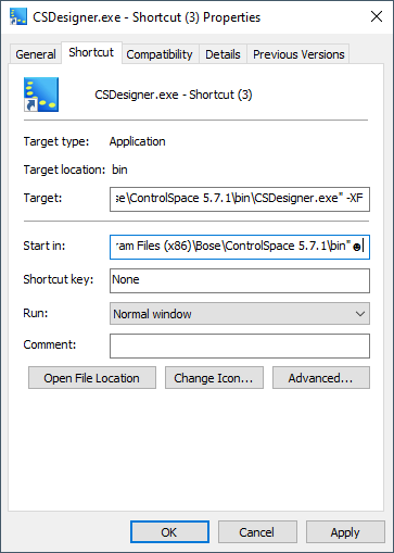

Hello Richard,
I hope you and your loved ones are doing well.
You can easily convert an ESP-88 file to ESP-00.
  • Create a shortcut of CDesinger.exe located in the bin folder.
    C:\Program Files (x86)\Bose\ControlSpace x.x\bin
  • In the shortcut properties window add "(space)-XF" at the end of the target path and click OK.
  • Start CSD using this shortcut
  • Open your ESP-88 design file
  • A window should pop-up asking if you want to convert the ESP-88 design to a ESP-00 design and click Yes
  • Save this converted file as a new design and you should be able to upload this converted design file
