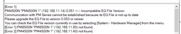

5.6 control space.
I try to update a pm4500 and a pm8500.
Now i cannot go further because control space said : i need the firmware 0.053 but in the software i'm up to date at 0.051
