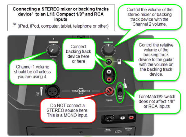

The L1® Compact Channel 1 is EQ'd specifically for vocal microphones. You may not be getting the best sound for your full range music (iTunes).
If you have a way to connect your iTunes to either RCA or 1/8 stereo, you can connect to L1® Compact Channel 2.  Set the ToneMatch switch to the Line Level setting (down).
Click picture for more details.
Do you hear a difference when you connect your music to Channel 2?
If you prefer the sound when you connect to L1® Compact Channel 2, then get a converter from XLR to 1/4" Tip-Ring-Sleeve and connect your Behringer mixer to L1®  Compact Channel 2.

ST's covered just about everything regarding the connectivity of the Compact and how to use it best. Regarding what ST's suggested I won't repeat his tips. They're basically what I've said myself.
@ST I can't seem to get the link in the picture to work ("Click picture for more details.").
