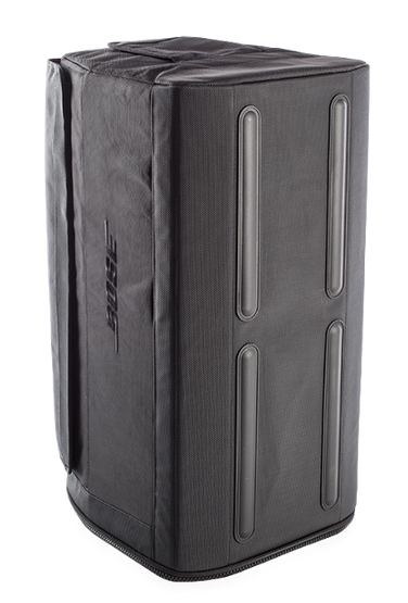

2nd question is about the case of f1 is it good? And i can see that the speaker can be placed on the front panel i think it'll have dents this way
There are rubber strips on the surface that covers the speaker front (grille)
I use these bags and have had no problems.

2nd question is about the case of f1 is it good? And i can see that the speaker can be placed on the front panel i think it'll have dents this way , so i found a bag in Rockville.. do u think it's better? What's ur opinion?.. really sorry for all these questions and thank u for ur time and help

@Rob Wright thank u sooo much that's what i wanted to hear , and if u have any infos about the bluetooth and bag please let me know and also about placing the speaker while in travel bag on front face.. as i saw a rubber from front on the original bag ... thanks again
