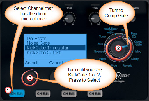

Also - have you tried the KickGate
(click the picture for details).
The feedback is a low frequency hum. And occurs when the mic is at a certain position inside the sound hole on the Cajon.
We do have a ToneMatch so we will try the KickGate setting. Thanks for the info.

I’m not sure the KickGate will help - it might.
The other thing to consider is using the ParaEQ.
See: Solving problems with the T1® ParaEQ
-== Please click the picture for more details ==-
