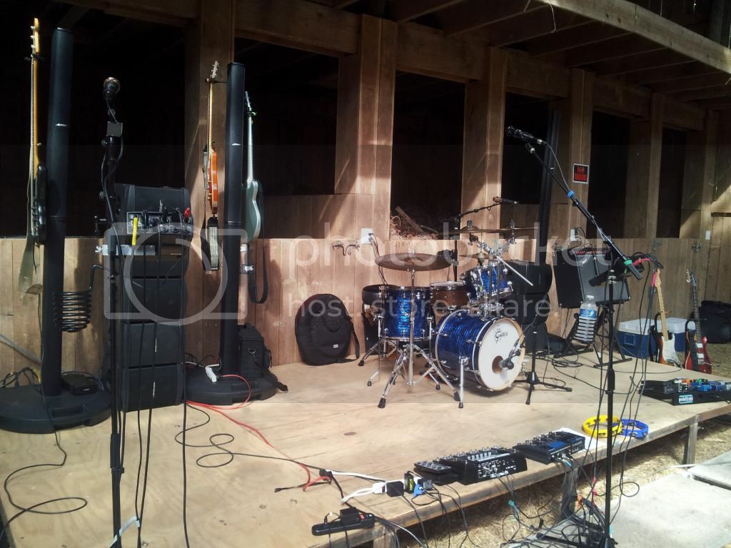

My four pc rock band runs three L1s (3 T1s, 8 B1s and 2 A1s). Going left (as you face the stage) to right - The bass player/backup singer has a model one and 3 B1s on the end of his side of the stage. My (lead singer/r.guitar) is next with 2 B1s. Then comes the drums. Then the L1/3 B1s that are shared by the drummer/backup singer and the lead guitarist.
The lead guitarist is the only person using a backline amp.
You guys are so close to having the ideal set up - that I’d encourage you to go full tilt and ditch the mixer in favor of 2 or three total T1s. Mix your sound in the air - not your board. I’d also recommend at least one B1 or B2 with each L1.
Here is a shot of our set up on an 8’ x 16’ stage:
