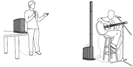

Just flying out of here for an early event but here is the gist of it (from the wiki). Note in particular - the part in bold.
The L1® Compact does not play as loud, nor as deep in bass, nor does it project as far into a room as either the L1® Model I or L1® Model II. If you are used to performing with a L1® Model I or L1® Model II you may find that you have to run the L1® Compact louder on stage than the others to project into the room.
The L1® Compact has extremely wide horizontal dispersion (like the L1® Model II. If you are using a vocal microphone you will probably have better gain-before-feedback with the L1® Compact off to the side a bit so the microphone is aimed away from the speaker array on top of the L1® Compact.
–== picture from the manual ==–
When I use the Compact I generally have it a foot or two behind me and two to four feet to my right. Here is a comparison - basically how I usually set up.

First of all, the L1 Compact is very different in basic nature from the two original ones. It has a head-high vertically-divergent array that is ultra-wide horizontally. the vertical angle is narrow enough so its sound pressure fall-off with distance is not as severe as, say, a guitar amp, but it’s somewhat greater than an L1 I or II. We have data galore taken on the L1C array, but to a musician, its not only useless, it’s confusing. Thinking about this stuff intellectually leads nowhere.
So, forgetting all this, The L1 Compact sounds the same and, from personal experience playing and singing solo, it feels the same. When I played (this seems to be a typical configuration), the system was off to the side 5’ and back of me 4’. It is louder when you get on top of it (unlike the L1) so you need to get a little further from it. But not much. It’s very well behaved and it’s easy to arrive at an organically-correct distance from it. But; bottom line; it really behaves like the other L1’s. I know it has less overall output than the big ones, but I never felt that limit playing demos for a variety of audiences prior to yesterday’s launch. I know the system will allow me to entertain at a level I’m happy with in our live music theater. I really don’t want more level from it. Our theater holds over 100 and is acoustically treated to be pretty dry. Charlie Farrin did the same on a number of occasions. He’s an experienced pro, playing guitar and singing to demonstrate for other audiences. As an audience member listening to Charlie, I was delighted with the sound quality and level. It was exceptionally articulate musically and I understood all his words, on songs I wasn’t familiar with. I’m guessing if you’re playing guitar or keys and singing (a solo gig), you can play for 100 with great quality. I never thought once about the capacity of the LF. My keys are never exaggerated on the low end and I want them to sound like, for instance, a real piano or a Rhodes Suitcase. I’m guessing an organ player playing a heavy bass line and singing, like a solo gig, might put the thing to the test. I haven’t experienced this and don’t do it myself.
