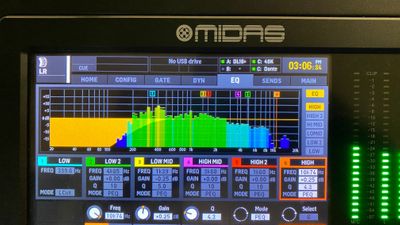

I want to pink our room based on the fact that we moved our MA12EX speakers from their original install AND that I feel that the original settings that our bose rep configured are too much mid-range in sound.
We have a Midas M32 running dante to our PM8500 bose amp and then to our 4 ma12ex and 2 bose subs.
Here is a snapshot of what we are currently seeing in our sanctuary.
Should I (a) change the settings in our bose PM8500 amp or (b) use Midas M32 to change the settings?
Hello gregrpbc,
I would advise to do this with the same PEQ as the Bose rep did, to prevent double EQ-ing.
Or maybe you can contact the Bose rep to get his advise for this project.
