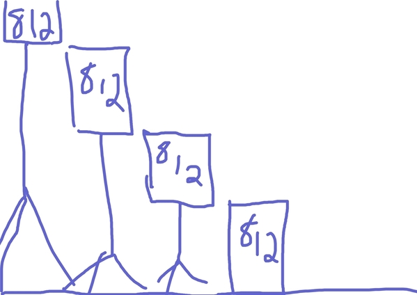

You need to stagger the grills height wise so that where one ends another beings (per side)... I suspect in practice this might be very hard to do using four F1 tops per side...
I have been trying to find the best way to run multiple systems as well.  How did you daisy chain so many?  Example left 812 to the other left 812s and left sub to other left subs? @jdbassentertainment.com Can you show an example of the stagger grills?

yes.. thats how I did it. I ran Left, Right, and Sub on Aux. all subs were daisy chained together. left speakers jump one to the next, same as right. again.. runing this close will cause comb filtering, and slight phasing.. .I'm going to see if I can rig a system to stack 2 of the tops on top of one another. That may be a better idea to get it done.
Please excuse the 2ND grade drawing, but you get the idea.EFB92475-01B9-4265-920D-8147745D3548
