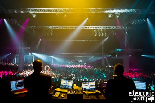

Aziz,
ST is correct … you should see the T1 as a center mixer in your setup.
If you look at :
each dj has it’s own setup … each setup connects to a central mixer, which is just a hub. This could be the T1 in your case. You do not use the soundcard abilities of the T1, you connect your S4 to it via the jack out/inputs. And your iMac to your S4.
