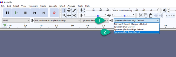

A friend came over today and we recorded a track from the T4S to my PC/Audacity.
When I play it back it goes to the PC speakers.  I'd like to play it back through the T4.  I even exported the file as an MP3 and played it with Windows Media Player which used to play through the T4 if it was turned on.
How do I get Audacity to play back from the PC?
Thanks
Hi Dan,
Click the Speaker Icon, then click Speakers (T4S)
All good?
