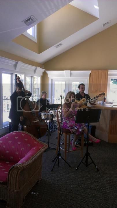

This past sunday morning i noticed that there was a champagne brunch thing going on at the neighborhood clubhouse - so I popped in to hear the band. It was a jazz trio (drums, guitar and upright - with backline) and a female lead vox singing through a Compact (direct - no T1).
This was the first time i had ever heard vocals through a Compact (I had heard a muso on the street in San Fran - playing sax through one - sounded great). While it was a clear Bose like sound that I am used to - I thought it really lacked guts. It just seemed so thin compared to what I am used to hearing from the Model 1 and 2 (with or without T1 in the M1 case).
The vocalist is a university trained singer (and the backing band were all topshel jazz fellows) - so the problem was not her, per se. Not being familiar with the Compact - I was wondering what they could have done wrong to make it sound so thin - or even if a T1 would have been helpful to her.
Surely the Compact can be made to sound good - or so many of you would not be big fans. I now wonder what they were doing wrong.

IMO she had good mic technique. I am a mic eater so I tend to notice these things. The thinness was definitely not due to air between her and the mic. The vocals were plenty loud - i just suspect that the product was not real representative of her voice.
I would wager that she'd sound off the charts through a Model 1 or 2 via a T1. She may even sound great through a properly adjusted Compact.
I don't think it was the singer. I suspect that something was mal-adjusted or in the vey least not optimized.
Also - I did not recognize her mic - so that is something worth suspecting. It never fails to amaze me how little thought people put into chosing a vocal mic that suits them.
