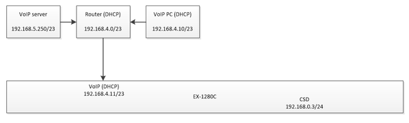

Are VoIP and CSD on different VLANs or different networks (separate switches)?
Is below overview correct?
VoIP network: 192.168.4.0/23
VoIP IP address (EX-1280C): 192.168.4.79/23 (DHCP)
VoIP server IP address: 192.168.5.250/23
CSD IP address (EX-1280C): 192.168.0.3/24 (Static)
What happens if you disconnect the CSD network cable (please power cycle the EX-1280C)?
You can connect to the webbrowser of the EX-1280C (192.168.4.79/23) when you connect your PC to the VoIP Network.
