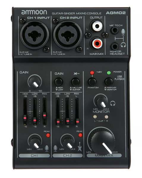

Hi Kjellarn - I unboxed an S1 about 4 weeks ago and ran into the same problem with my SM58.
I purchased an Ammoon AGM02 2 channel mixer (AU$79) which is powered by a 5v USB mobile phone power bank and run both my mic and guitar through the mixer leaving one of the S1 channels free. Try different tone match settings on the S1 to suit your own sound and venue. The small power bank (14400mAh) will run the mixer for about 20 hrs! I don’t use the EQ or PAN on the Ammoon, so they just sit on null(0), I use a Zoom MS50G to EQ my guitar.
i use the S1 solely for busking and I can’t tell you enough how fantastic I find it - great sound, portable, long battery life etc. And loud! But it now realise that the S1 is primarily a PA, and the use of a mixer is almost mandatory.
Cheers, Peter (Sydney Australia)
